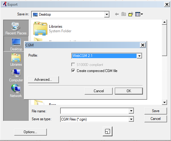

When we save a CGM and reopen it we lose lineweights and leader lines get exploded off of the object that it is referencing. What kind of CGM should we be Exporting to in order to retain lineweights and leader line position...if we want to use CGMs as our native format versus ISO?
    August 31, 2012
    Hi, Just try the below settings and check. It may work. While exporting the iso as cgm the pen weights are displayed in units inspite of the the PEN NAME we keep in isodraw file.
    Thank you.
