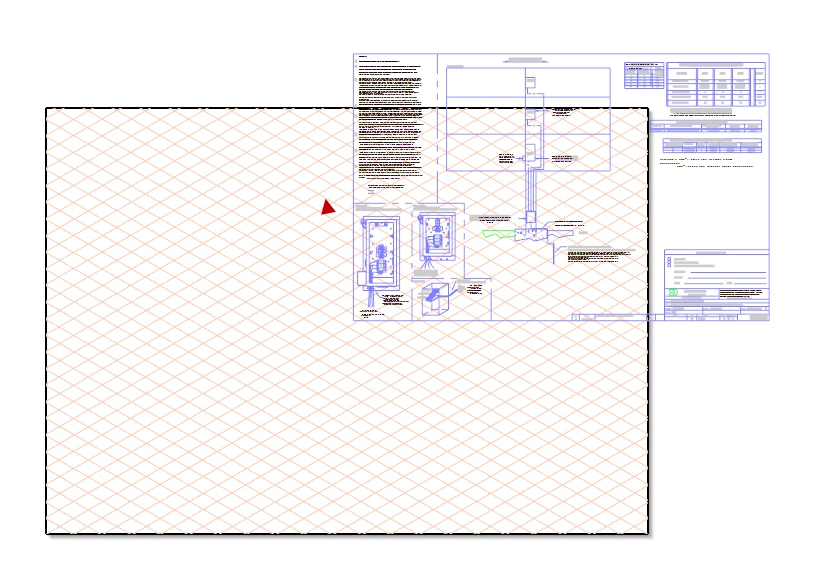

Is there a way to change the origin of the IsoDraw drawing field?
Here's my issue:
Whenever I open a .dwg or .cgm (based off of a .dwg) the file is located in the upper-right of the drawing field, with some of the drawing extending beyond the edges of the drawing field. When creating a PDF, all of the info beyond the edges is left out, so that info is essentially lost. Bringing in a PDF or picture, however, does not have this happen and it looks like they align with the center of the IsoDraw field.
I know that I can just select and drag the whole thing so that it fits inside the drawing field, but is there a way to set up IsoDraw so that this happens automatically and/or by default?
See attached picture for reference to placement upon opening the drawing.

September 19, 2013
I set up thise macro as-is and it basically just moved the drawing to the opposite corner with parts still overhanging. I edited the macro so that it would stop after "select none" immediately below "#Move temporarily to 0,0....." and it seems to work.
One other thing to ask: is there a way I can get the macro to run upon opening a .dwg? I.e. create a preference?
September 19, 2013
Nothing in the preference file but you can change the shortcut to IsoDraw to include a parameter to kick off the macro on startup. I do this from line command on occasion where the built-in batch tool didn't work the desired way.
