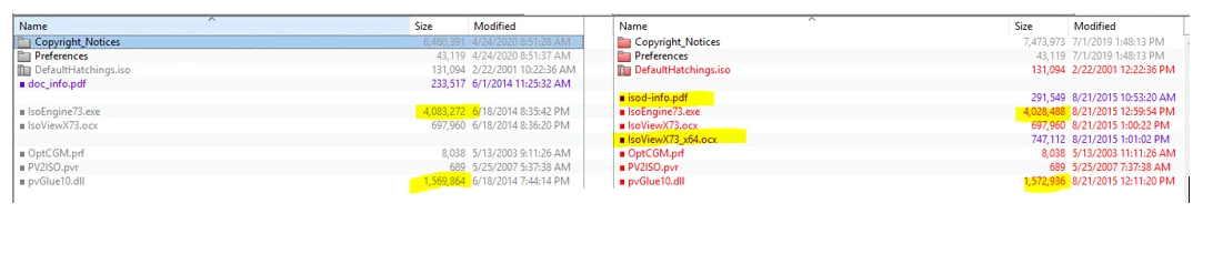

Is there a license or anything I need to look at? I compared a working machine to his, and I did notice a few missing files:
  1. c:\Program Files (x86)\PTC\PTC Arbortext IsoView 7.3\IsoViewX73_x64.ocx
  2. …\isod-info.pdf
  3. IsoEngine73.exe was smaller in size.
