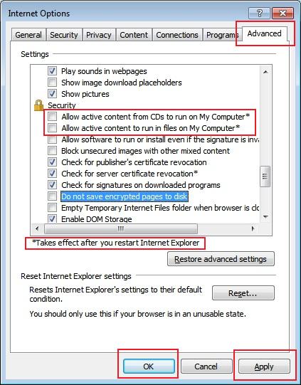

Dear All:
I just installed the ISOView 7 on my window 7 workstation, not problem encountered.
But I reallies that I need to disable the protection mode (which by default enabled) in order to view the cgm file in IE with ISOview. Does is possible to view the CGM file with isoview 7 without change the default setting?
Thank you.

    Hello!
    Chu Soon Tan wrote:
    ...But I reallies that I need to disable the protection mode (which by default enabled) in order to view the cgm file in IE with ISOview...
    Please explain what you mean.
    Also you can use "Creo View Express", which allows you to open files in the formats ISO and CGM: http://www.ptc.com/products/creo/view/express/
    January 12, 2012
    Hello:
    I download and installed the isoview 7, before i can view my file (cgm) in IE, i still need to disabled my IE "Protection Mode" (for vista & Window 7 only).
    Does is possible to make ISOview plugin run under IE "Protection Mode"?
    Thank you.
    chusoon
    January 16, 2012
    In Internet Explorer go to "Tools" -> "Internet Options" -> "Advanced" tab -> "Security" section. Then activate the following options: “Allow active content to run in files on My Computer” and “Allow active content from CDs to run on My Computer”.
