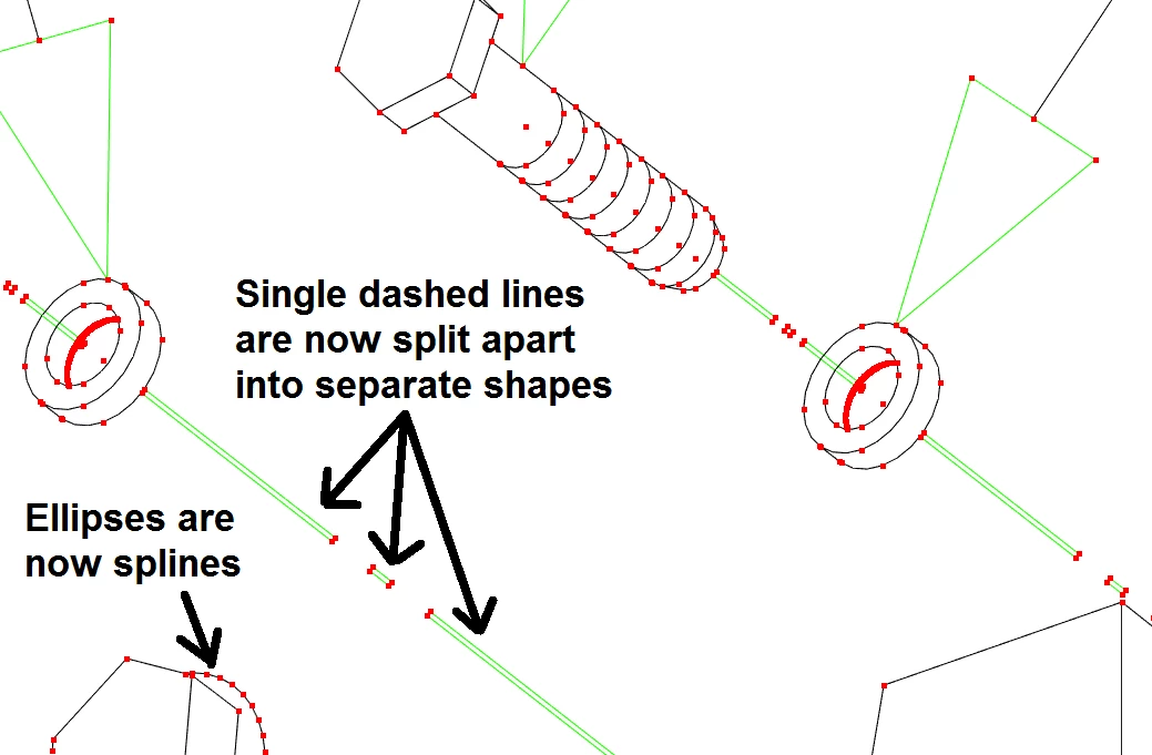

Issue:  When opening CGM files (converted from 'Tech Illustrator') into the 'IsoDraw' program, many of the ellipses come through as splines, and all the dashed lines are split and converted into separate polygons (***Screenshot attached***).
Anyone know how this issue can be solved so that all ellipses and all dashed linestyles are preserved when opening CGM files in 'IsoDraw’)???
