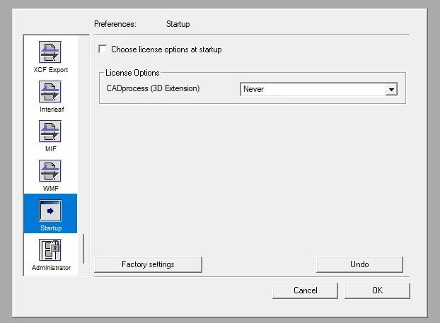

Is it possible that the 89 older files were created in Isodraw CAD Process and your new 7.4.3 license is only for Isodraw Foundation, or your Isodraw startup is set to CAD Process - Never?   I just ran into this a couple weeks ago.  I batch exported drawings created with CAD Process to CGM files on a machine with a CAD Process license so other users with Isodraw Foundation could open and edit the drawings.
