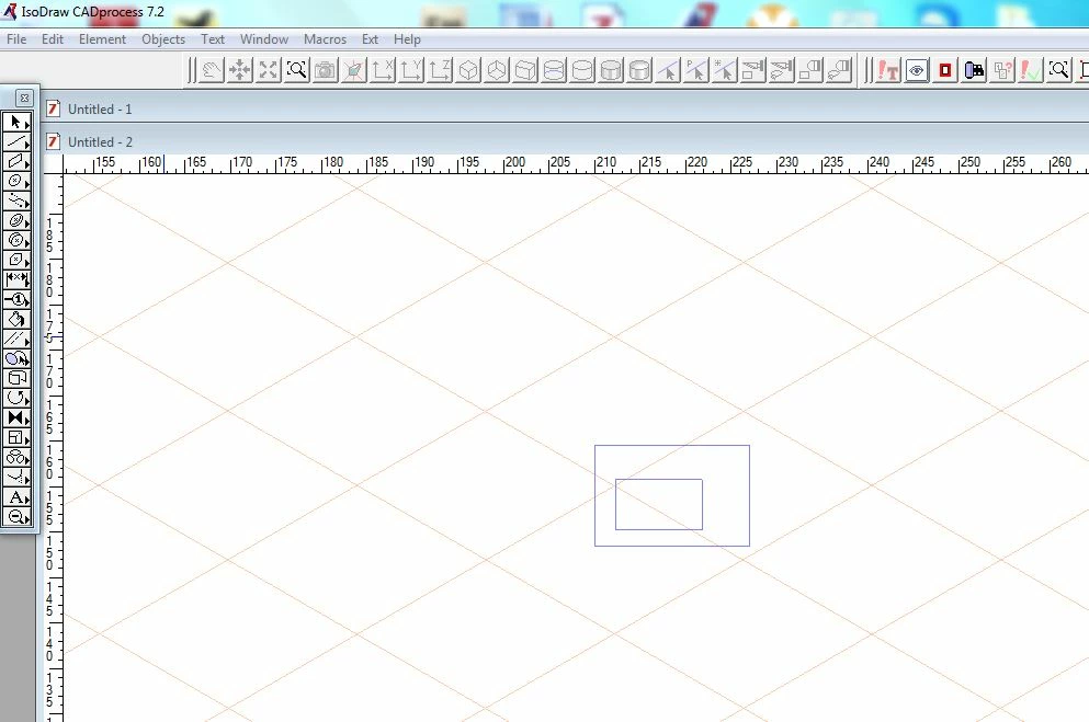

    I'm not an IsoDraw expert and don't spend much time working with it, but I never experienced what you mentioned. At the moment I'm on 7.2 F000 and getting solid lines when opening your sample file - see the attachment.
    Since 7.1 M040 is a bit outdated, I'd suggest trying 7.2 F000. It's newer release and, more important, there were quite a few improvements/enhancements introduced in regards to importing DXF/DWG (Release Notes).

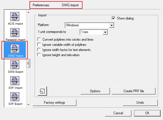

    Try to look at options of import of a file for format DWG ("Edit"-> "Preferences"-> DWG Import):
    Aug 4, 2011 3:39 PM UTC
    Thanks for responding, but I didn't see anything there that looked like it would resolve my problem. Does the same thing happen to you when you try to import an AutoCAD drawing. I've attached just a basic drawing if you don't have an AutoCAD drawing available. Nothing fancy just a couple of rectangles.

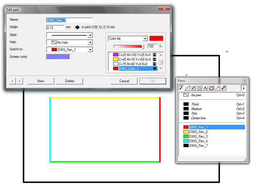

    I opened your file in versions of Arbortext IsoDraw 7.1 M060 and 7.2 F000 and the result after the "Preview" can be seen below (there is no "dashed lines"):

    Thanks Dmitry, looks like that will solve my problem. I just have to get management to OK updating to 7.2 and evaluate it to make sure we don't lose any functionality of our add-ons. Like I said I'm new to IsoDraw and just thought I was running the latest and greatest.
