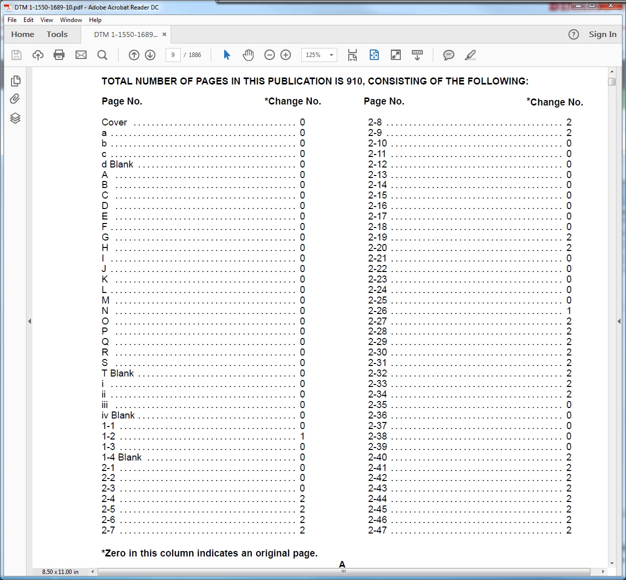

I understand your approach, but I would have to implement another approach using same mechanics due to the fact that my LEP requires to indicate the level of change (see attached picture), and not just if there is a change on the page; and therefore, I would store the page numbers by using the pageString into an array and the change levels into another array, both indexed on pageNumber, and then pair them up based on index.
To do that I have created a property set to which I added a source code that would capture in two separate variables the pageString (formatting.currentPage.pageString) and pageNumber (formatting.currentPage.pageNumber) and store the pageString into the application.arrays.lep. I stored the pageString because some pages in the document would be counted as A, B, C…, i, ii, iii, iv, …, and I used the pageNumber as the index for the array. Once the edited source completed, I did add the property set to all the relevant elements/contexts/conditions.
One of the problem I have encountered is that adding edited source to each relevant element/condition/context would not “register” all the pages that the element spans on. For example, if an element has so much content that can be span on several pages, only the first page would be captured to be stored into the array. I tried to add edited source on page sets and then on page types but I did not get any different result than adding source code on elements. How do I capture blank pages if there is one?

For the blank pages, it would depend on how they are being output. Perhaps if you have a UFE or something that is wrapping the "intentionally left blank" text, then you could use that to trigger the LEP capture.
For the content that spans multiple pages, the easiest method would be to store the start and end page folio for that element and calculate the values in between. e.g. for <table> and </table> you would store the start and end folios. That will be a pain if your change starts on a folio "iii" and ends on "F" or "13" instead. The other approach is to have APP do something at the top or bottom of every page but that will get complicated ("frame reference" and "page event" respectively).
