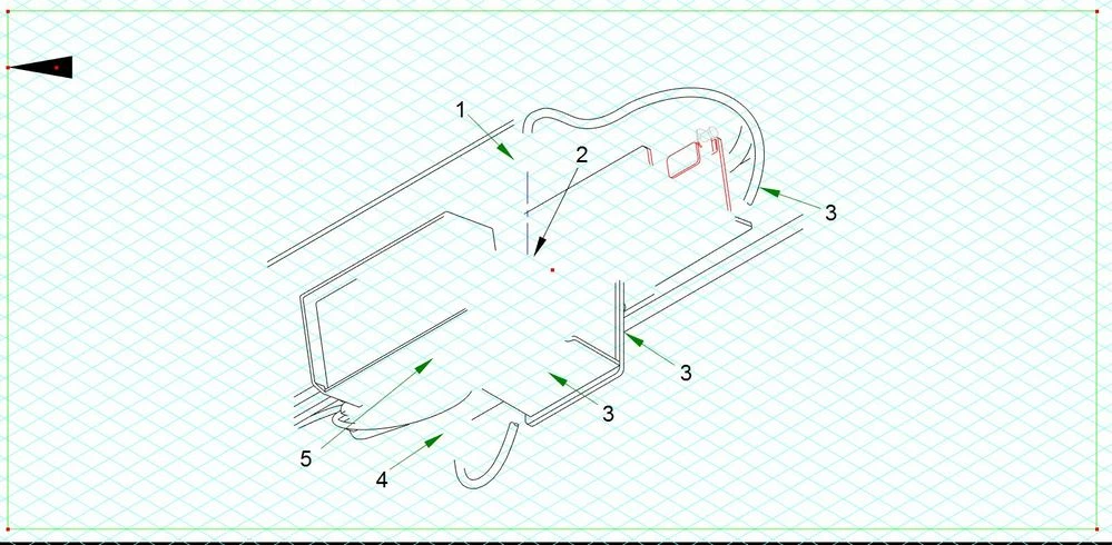

Macro for IsoDraw 7.2 Move Rectangle corner to line anchor point
Ex. I have a rectangle in my ISODraw document (this is our format border). I already have a macro that I created that will select all the text and art created for this particular document. Then aligns it all in the center of the rectangle border and then aligns to the bottom then moves it up a specific distance. So that every document of art we create is centered and at the same exact distance from the bottom of the border. The border does not change in width and the bottom of the border does not move. The height will change depending on the height of the art and text. To change the height we will move the top of the rectangle border down to the correct height. I have a line created that aligns to the top of the art and text and then moves up a specific distance to mark the spot where the top of the border line should be snapped to.
The part we have to do manually but I want to figure out how to code is as follows:
We have to manually select the top of the rectangle and drag it down to snap to the point of where the line created ended up. This spot is always different because the art and text are different depending on the document.
I want to learn how to code the macro to get the coordinates of the front anchor point then apply that coordinate as the marker for where the height of the top left corner of the rectangle border will be readjusted to.
Hope this makes sense! My understanding is I need to make the coordinate of the created lines front anchor point into a float and have that apply to the coordinates for the top left of the rectangle but not sure where I go to learn this kind of coding that would apply to ISODraw macro language. I've tried looking into C, C++, or searching for stuff like "Beginning SAS/IML code macro" in Youtube and Google. But everything I come across is not helping me.
Please help.
Below is the example of the macro I have so far explained above. Keep in mind it does more the what I said but what I said is the important part relating to my question. Also a pic of the line and rectangle explained above.

BLArtsAnswer
Apr 27, 2018 3:36 PM UTC
I figured it out!
Macro Breakthrough
DEFINE pathstart AS float
DEFINE pathend AS float
		Select if Object_name contains '2017_Temp_ArrowPen_AlignBorderTop'
pathstart = activeDoc.firstSelectedElement.line.segments[1].endPoint.y
Select if Object_name contains '2017_Main_Stay_MainBorder_PenNoPen'
	activeDoc.firstSelectedElement.rect.segments[3].endPoint.y = pathstart
pathend = activeDoc.firstSelectedElement.line.segments[1].endPoint.y
	activeDoc.firstSelectedElement.rect.segments[2].endPoint.y = pathend
End macro
