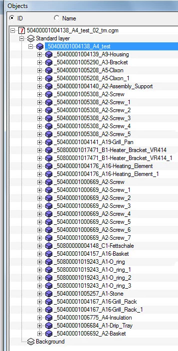

How do I create a macro for IsoDraw CadProcess 7.2 to be able to edit the object id of the assembly group and then copy that over to the object name so that both the object id and object name are the same? Also I need to truncate the object id and name to only show the characters to the right of the hyphen.

RubenCote1-VisitorAuthor
Nov 20, 2014 3:19 PM UTC
By default the object_id has an underscore and a different number (example,screw _1, screw _2, screw_3, screw_4) to the right of the hyphen. So the system has created a unique object_id. I just want to strip the engineering number out of the object_id and then copy that to the name_id. Having the object_id and object_name can be the same, I think. Isodraw does not mind that. I'm thinking a while statement would check to see if the condition exists. So those that don't match would have to be fixed manually, but at least the bulk of the list would fall under and be fixed by the macro. Right now I'm doing the renaming of object_id and object_name by hand and it takes too long. Hence the need for the macro. My end goal is to export the file once the renaming of the object_id and object_name has been done to a .u3d file that will be placed in an acrobat pdf file.

Okay I was able to make a macro that truncates the Object_id and copies the output over to the Object_name. The only problem that I'm having is that it is not looping. If I select and run the macro from the list it changes the next item on the list. Need to have it loop. I added a while statement but not sure what I did wrong to not make it loop down the selected list. Any help is much appreciated.
