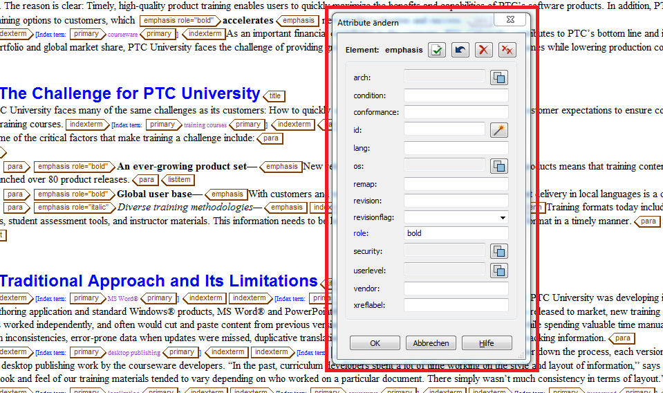

Hi guys,
in arbortext editor 7.0 we would like to dock (right) the Modify-Attributes Dialog:
For our users it would be very helpful, to modify attributes of the current tag always in a docked attribute window.
Our aim is to dock this window, and update the element, so that every attribute of that clicked element can be changed very fast.
Therefore our plan was to reload this window if the oid_tag has changed. We tried to find this dialog as xml to try to dock this, but without success.
Do you have any other idea to realize this feature?
Thank you in advance for your help.

to get this window docked, meanwhile we build our own modify attribute dialog with xui, which we start docked on the right side.
