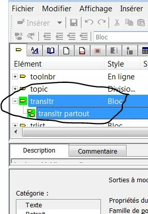

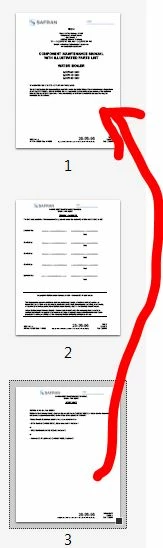

Currently using ArborText Editor with Styler 6.1. I am attempting to change the pages location after publishing my document to PDF (I need that my document start by transltr). I am using FOS folder (.fos)

If I understand the question correctly, your pdf is opening on page 3 and you want it to open on page 1? If so this can be done in Adobe pro. Click file, properties, initial view and change open page to 1.

No, the problem is more complicated than that. I have a FOSI that gives me after the publication of my PDF document the page 1 instead of the page 3.
I look for the parameter that allows me to change the position of the pages in the fosi.
