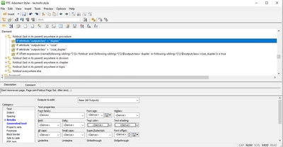

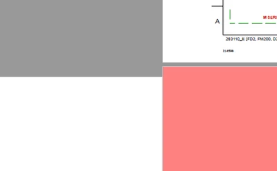

I made a foldout context to duplex the second foldout. The issue is that it keeps making a third red page.
Error says
<Level>ERROR</Level><Message>Pg 3 New page sequence not specified;
used fallback 'defaultPage'. [1035] (1:"editorDom0"#{2;/})
</Message>
What does it mean? I have my foldout page set

What comes after the duplex foldout? Is it set to start on a specific page type (odd/even)? Maybe that's where the blank page is coming from.

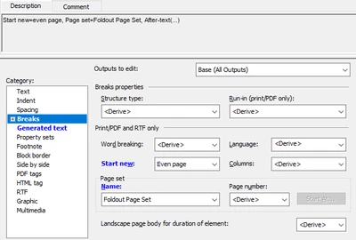

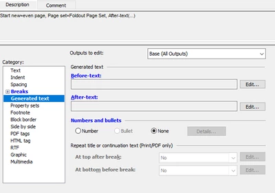

I am trying to use the second foldout outputclass:duplex as the back page to the first duplex. It does work, but it keeps making that extra third page.

What I mean is, it may not be the foldout pageset that is generating the blank page, but the one following it. For example, if your duplexed foldout is an even page, and whatever comes after the foldout is configured to "start on new even page", it's going to stick a blank page in there.
