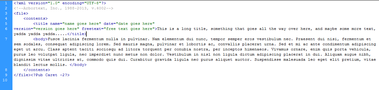

When Saving an XML, simply opening a file, then Save As, the XML is breaking an element/line, rather than maintaining the original format:
Start:

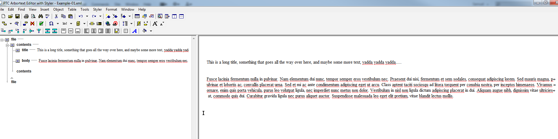

Abortext 6.1 view:

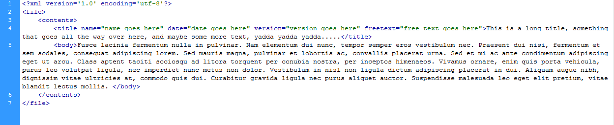

After (Save as) - Notice the break at Line 5 / 6
- Abortext also adds it's stamp (Line 2), can this be turned off?
    Best answer by GarethOakes
    The "Arbortext stamp" I don't believe can be turned off. Arbortext has a large number of preferences for controlling behaviour. The two most relevant to what you are concerned about are "outputrecordlength" and "writenobreakattag".
    You can find the full list of preferences under Tools -> Preferences -> Advanced. Note that some of those advanced preferences also have user-friendly counterparts under the regular Preferences dialog.
    April 15, 2014
