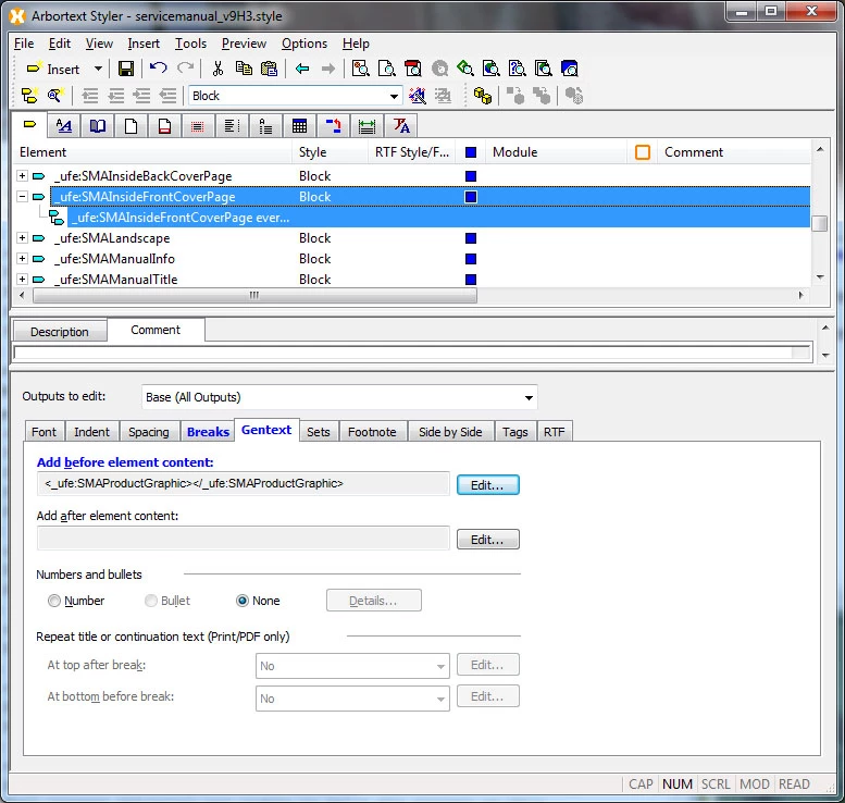

newbie style sheet help- getting picture to show on back of front cover
Trying to get an image to show on the inside of the cover page, this image will need to change depending on book published. I am in styler and using the sma portion of the program. Do I need to change the ufe:smainsidefrontcoverpage ? Under gentext, i have add the markup to use productgraphic and have also tested ufe:SMAproductgraphic. In my ditamap I have a productgraphic listing and have the href set to the graphic location. Nothing seems to show up unless I insert the graphic directly onto the ufe:smainsidefrontcoverpage.
any help would be much appreciated.

    Thanks for the video, I have tried your suggestions in the video and I can duplicate it with the sample file. Thank you. I am now trying to use my own ditamap and graphic. I can not duplicate it. I am using a cgm graphic as my file. Is there a way to set this so my inside cover looks to the product graphic reference. I am wanting to use this for more that one book and would like to change the productgraphic in the main screen where the product.png is called up. I can double click on it and it does show me my graphic. I figured it has to be a path issue, so I put my graphic right beside the prodcut.png graphic and is still does not show.
    Thanks for you help.

    Bryon, what Arbortext version and build are you using?
    Are you getting any errors when composing the document? Can you provide your ditamap file or a screenshot of it where <productgraphic> and it's attributes are visible?
