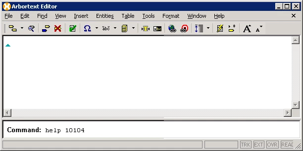

    January 25, 2012
    type "help 10104" on the command line in Editor. Or search help for "deep
    content splitting overview" which is the name of the help topic 10104 (at
    least in 5.3 m110).

    January 25, 2012
    On your Arbortext Editor command line type: help 10104 and press enter.
