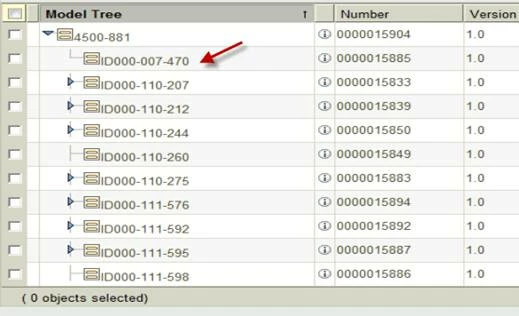

When you use the built-in object browser within Editor, the structure displayed follows the document structure.
[cid:image002.png@01CC47B6.3481BF00]
When you use the display the structure within PDMLink browser I can't seem to find the way to sort the same way. It seems to only want to sort numerically and not base on document structure.
[cid:image005.jpg@01CC47B6.34971BC0]
Does anyone know how to sort by document structure within PDMLink.

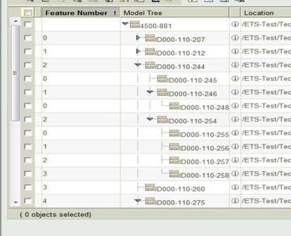

    Jul 21, 2011 9:10 PM UTC
    Brian,
    Try adding line number to the view and sort by line number then name.
    Mike
    byork17-PeridotAuthor
    Jul 21, 2011 10:02 PM UTC
    Mike,
    I ended up using feature number. That seems to work ok.
    [cid:image002.jpg@01CC47C7.FFA8AC50]
