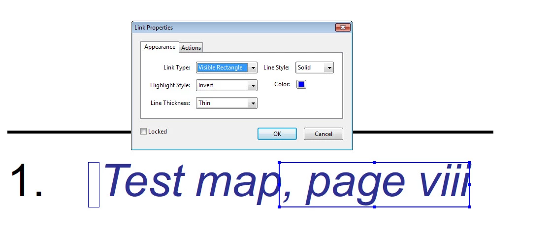

We are creating a ps file from editor then sending it through distiller. We are getting a thin visible box being generated around xrefs in footnotes. The xrefs in steps are ok. Does anyone know where to modify this? We can do it in adobe pro using the add or edit link feature and changing the appearance to invisible rectangle, but it would be time consuming.
