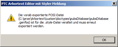

Pre-exported FOSI file is deprecated for the .style data and must be re-exported
Hallo Guys,
can someone please help me with this? I always get this error when launching an Arbortext document.
greetings sam

    There must have been a style sheet change. In styler open your stylesheet, go to file, export fosi. Save this file in the same location as your stylesheet. Rename the fthe file from .fos to .genfos. Close everything and reopen.

    Hi Bryon Friesen‌,
    thanks a lot. Was no problem with the described method I just overwrote the file pubsDitabase.genfos then the message was gone.
    greetings sam
