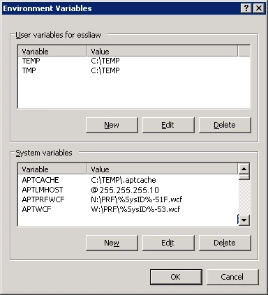

    Default location is in the user's home directory, but I use the APTPRFWCF or APTWCF environment variable to force all of the preference files for my users to a central network location so I can troubleshoot problems (at this location home directories are not readable by anyone except the user/owner).
    Set APTWCF= \\server\sharename\\PRF\%ComputerName%.wcf (or I suppose it could be %UserName%.wcf)
    I have two versions running on different machines and the %SysID% environment variable is the same as %ComputerName%.
