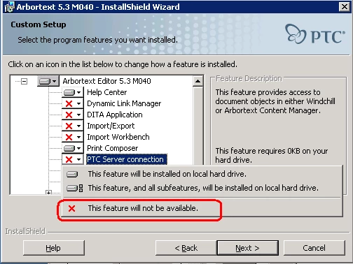

    The installer for 5.2 and up includes it as an optional component that
    you can check/uncheck, but it is still ehre.

    I can't speak for higher than 5.3, but print composer is just an installable feature (that is NOT installed by default).
    PTC would rather sell you a server based feature, but as long as we have the license for the client side print composer feature it should still be available.

    Print Composer is a separately-licensed feature of Arbortext Editor. You can install it when installing Editor by selecting the "Custom" installation and selecting Print Composer from the subsequent list.
    jgroves1-VisitorAuthor

    Thank you Andy, If I had opted to do a custom install, I would have seen it.
    Thank you for the help, I really do appreciate it.
