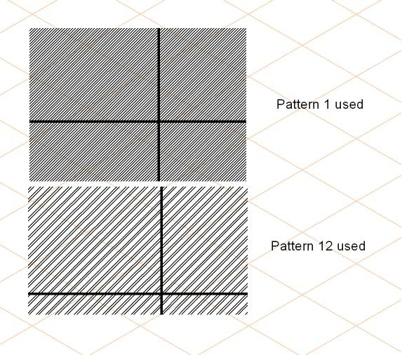

Hello Everyone,
I am working on S1000D Standards. I have create some Hatch Patterns (view the iso file attached).
When I use these patterns it would be fine. Once I close the file and again open the same file I get the preview of the hatchings (view the attached jpeg file).
Could any one please suggest how to get rid of this problem as I would be using this patterns daily.
Best answer by ptc-4684651
Finally I got the solution for the problem!!!
*Vladimir I tried using the macro which u suggested but it didnt work.
So I created a file with hatching all over the page size which i required and then saved the file in the patterns folder of isodraw. So I created some 10 files in different hatch patterns and now the problem is solved.

Please look in this topic: http://communities.ptc.com/thread/38562
September 12, 2012
Thanks for the reply!!!
But the problem explained in the http://communities.ptc.com/thread/38562 is different. (the problem explained in the thread is due to improper tesselation).
But in my case It appears correct if I fill the hatch for the first time (tesselation is correctly calculated) and when i close and open the file it appears as shown in the jpeg file.
September 12, 2012
Mahesh C J wrote:
...But in my case It appears correct if I fill the hatch for the first time (tesselation is correctly calculated) and when i close and open the file it appears as shown in the jpeg file...
Did you executed the following rule in case of creation of hatching template (from here: http://communities.ptc.com/thread/38562)?
bgraffmann wrote:
...Each lineend on one edge should match one on the aligned square.In your case, the diagonal lines have the same distance from each other, but a different distance from the corner of the square! If you need a hatching with a defined distance of the diagonal lines you might need to adjust the size of the square...
ptc-46846511-VisitorAuthorAnswer
March 15, 2013
