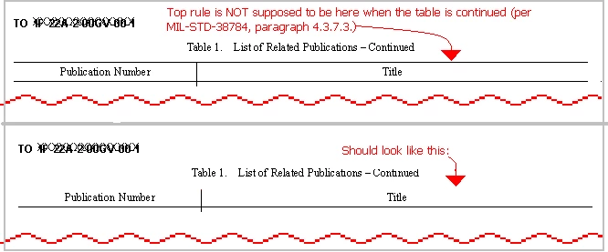

Using Arbortext Epic 5.3m040 running on Windows XP with 3 gig of RAM installed I am encountering a problem that I thought was solved y a custom.tmx file back in 2008. When a table continues to another page Arbortext Editor with Print Composer is repeating the top rule. This is not supposed to happen and I have no clue why it is happening now.
Does anyone else have this problem or a different fix for it?
Here is a snapshot of the top of the page and the applicable portion of the custom.tmx file:
[cid:image002.png@01CD554B.109375E0]
