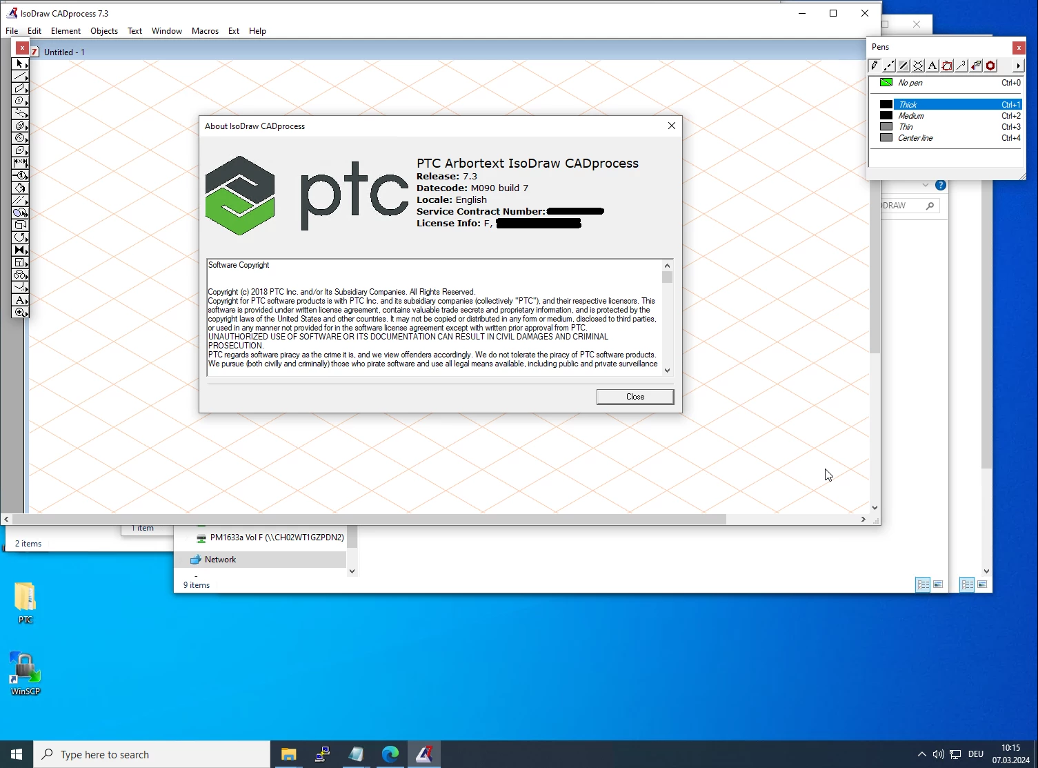

PTC Arbortex IsoDraw 7.3 M090 Build 7 crashes on application startup
On a few Windows 10 machines in our company PTC Arbortex IsoDraw 7.3 M090 Build 7 crashes on application startup. The app starts and as soon as the empty untilted project tries to be opened, IsoDraw immediately closes without any further error message. On other similar windows machines, IsoDraw starts just fine.
Are there some log files we can have a look at (where are they located) and how do I contact the official support, since we pay licensing for this IsoDraw software?

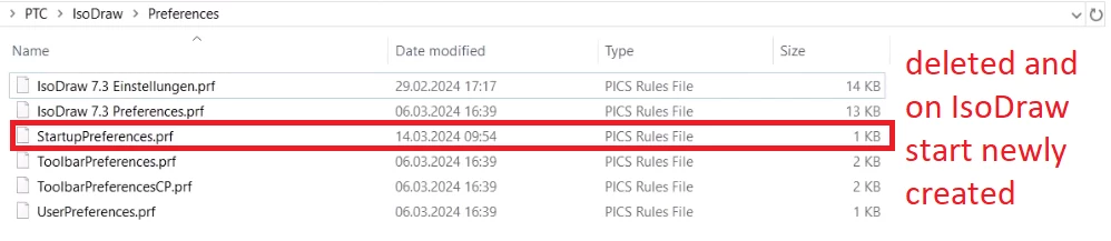

3-Newcomer
Mar 14, 2024 8:57 AM UTC
Unfortunately, it did not help. The symptom stays the same that on the complete startup of IsoDraw it immediately closes 2024-03-14_09h55_42.png

3-Newcomer
Mar 14, 2024 8:58 AM UTC
We tried the deletion of the startuppreference.pf file, which is a bit more drastic than your proposed solution, and it did not help

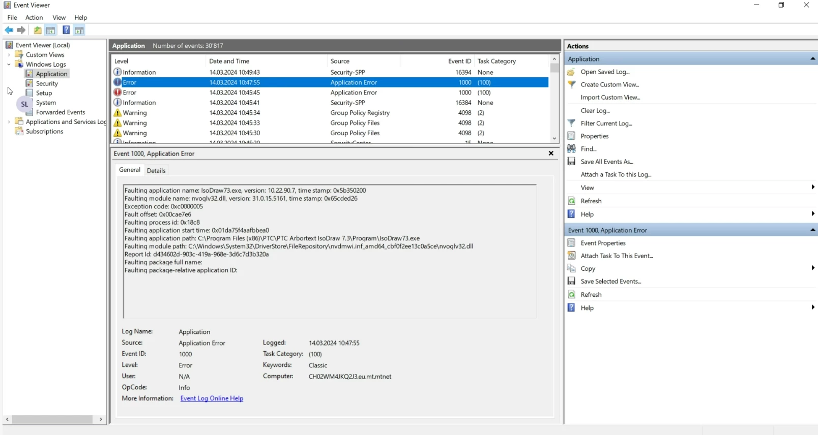

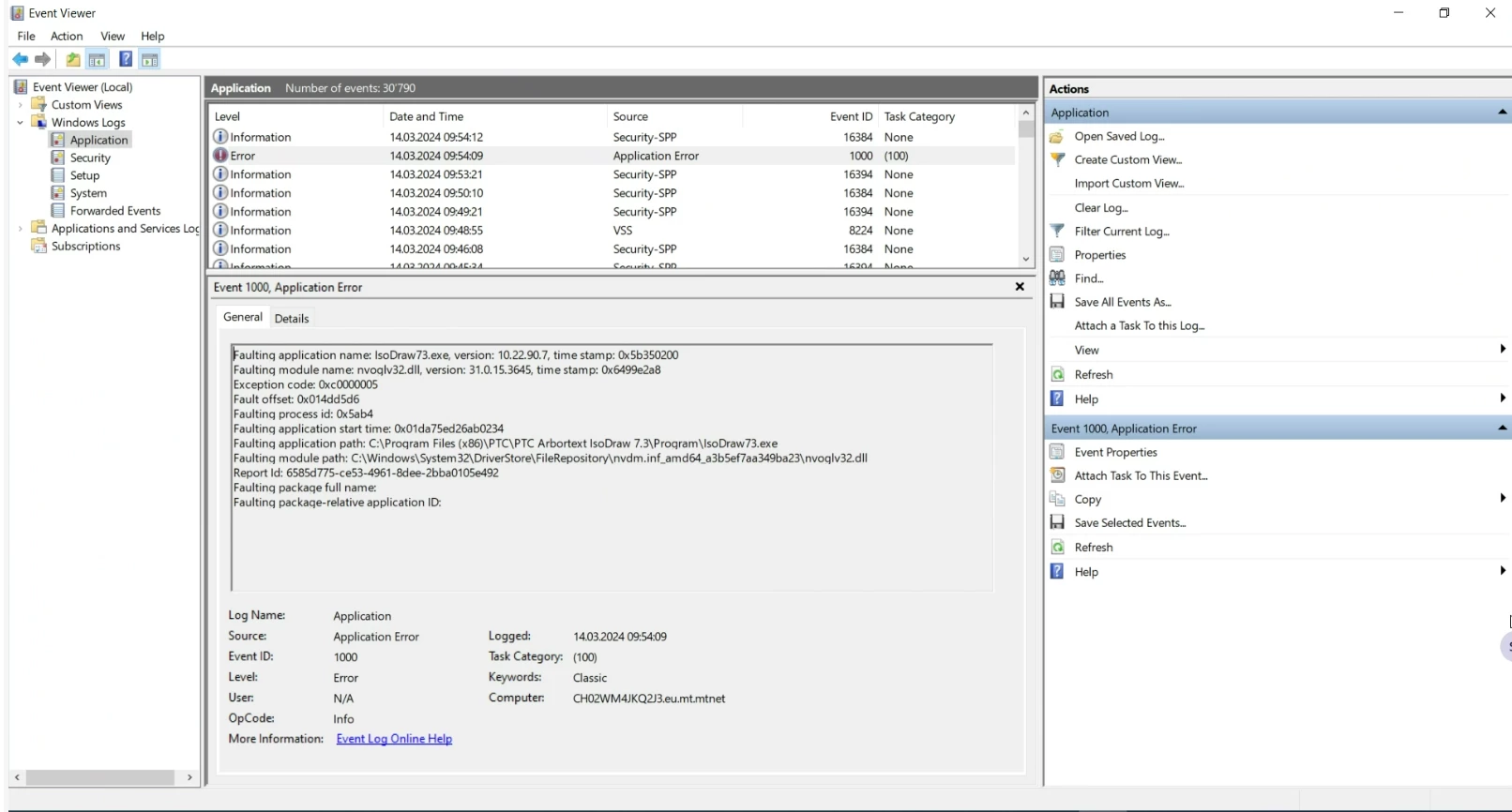

3-Newcomer
Mar 14, 2024 9:56 AM UTC
Looking at the event viewer it hints at a nvoqlv32.dll that faulted on the IsoDraw startup. Having researched that file, it seems to be Nvidia driver related. We installed the latest Nvidia driver for the laptops T1200 graphics card, but the error is still the same, see event viewer error messages. Again, this crash only occurs in the Home Office with being connected to VPN and not in the office itself (without VPN).
