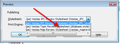

I would like to know in which folder/file the stylesheets are confiugred. Actually the Arbortext Editor clients got the list of stylesheet from PE.

    Thanks!. I don't see any stylesheet associations in DCF file.
    Actually I would like to change the order of stylesheet listed in the Publishing preview option of Editor.

    Hi Bala,
    Please take a look in the Arbortext Helpcenter: Administration->Arbortext Editor->Adminsitrator’s Guide->Stylesheets->Configuring Stylesheet Order in a list
    You need to modify the .dcf for your doctype (ditabase.dcf if you are using DITA) in your custom folder on PE to make this work. You may have to experiment whether you need to enter full paths or just the stylesheet filenames in the dcf.
