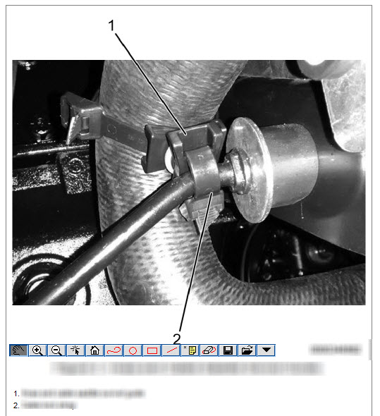

I've been using IsoView 7.3 as an Internet Explorer plug-in to view CGM, TIF, etc. images.

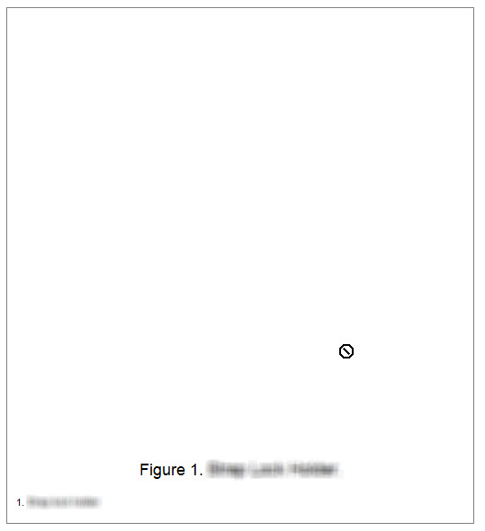

I found on IsoView datasheet that it also supports pvz file format. So I included a pvz animation on a webpage, but IsoView only shows an empty frame.
The TIF images display properly on this same page, though. Please see the two screenshots.
Any help will be much appreciated!
Viewing TIF:
Attempting to view PVZ:

While it is true that IsoView can display a PVZ file, the capabilities are very limited. Creo View would be a better, richer viewer for PVZ files.

Thanks Tim. I think I will need to research a bit regarding how to set up IE, so that by default it will use Creo View instead of IsoView to display PVZ. Currently it is always using IsoView to display almost all graphics, for example TIFs and CGMs.
Feb 24, 2015 6:51 PM UTC
Do you have IsoView installed on the machine that is viewing the HTML file?
If not, then the graphic will not display.
