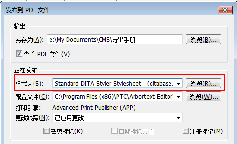

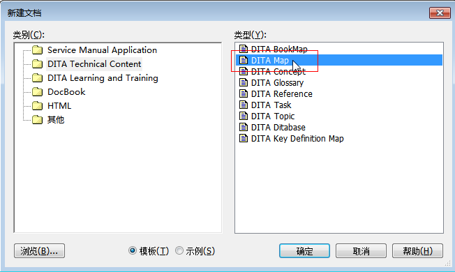

I make a manual map, but I need publish the document using the topic's style. How can I control and set the ditamap's stylesheet associate to the topic's (or chapter's or a customed DTD topic‘s) style. Thanks!

make a dita map.
select the stylesheet, how can I control and set the ditamap's stylesheet associate to the topic's (or chapter's or a customed DTD topic‘s) style

This sort of depends on what version of Editor you are using. As of 6.0 (I believe), all DITA documents, whether a Map or Topic, use the ditabase.style for composition.
If you have created a custom stylesheet that you wish to use, make sure it's located in a folder the Editor has access to, and then use the menu option "Format -> Select Stylesheets" In the dialog that opens, you can then highlight the one to change, and click 'Modify', and you should see the available stylesheets.

Yse, we use 6.0, and I also select the stylesheets follow your suggestion, but the problem maybe is I use the topic‘s stylesheet, to publish the bookmap...
When I publish the topic "FT220.24.001.xml" and "TE324.20.xml" using the customed stylesheet, is OK. But when I publish the bookmap, I think maybe is also using the default stylesheet. So I confuse it: how can I control the bookmap's style in the customed topic's stylesheet?
