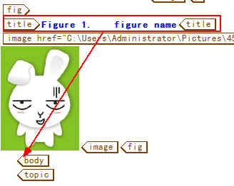

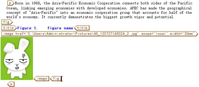

2. For the <fig> element, how can I chage the <title> under the <image>? I think we need update the DTD, but can you give a simple example for the steps? Thank you very much!

#2 is a common case for figures. You don't need to change the DTD. The usual mechanism is to either suppress the <title> or the <image>. You then display one before the other using gentext, which effectively reverses the order.

#2, great, I think I can change it in the gentext!
But what's about suppress the <title> or the <image>? I'd like to know in details.

For #2, suppress means you change the display to "Hidden". You can then use gentext to redisplay the content in a different location. Again we can assist with training or services if required.
