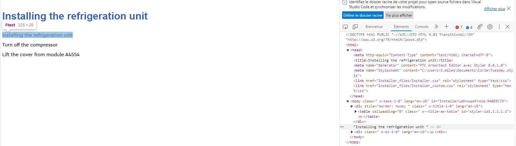

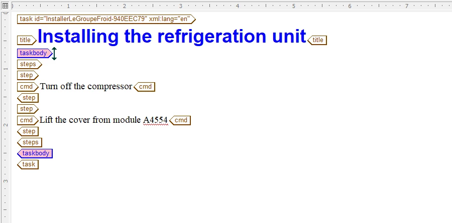

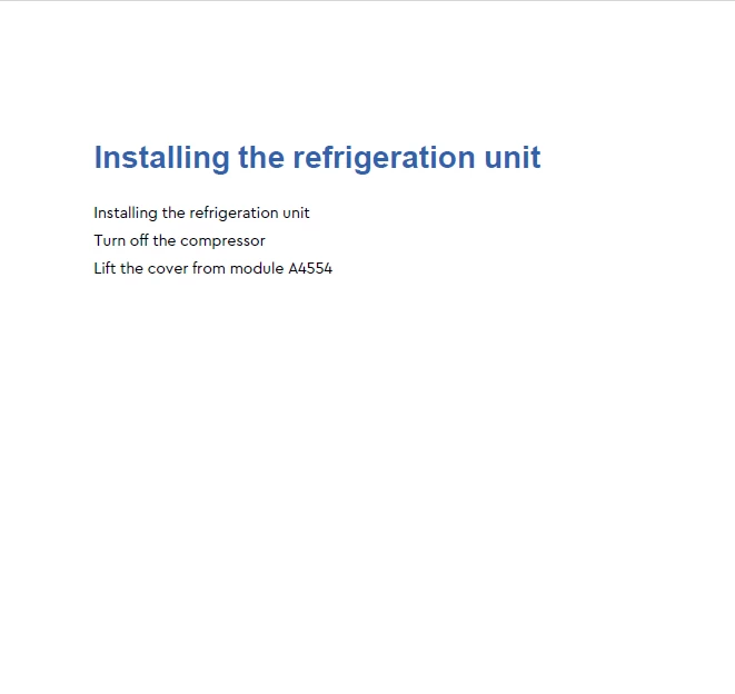

When generating output from a very basic DITA document using a stylesheet with minimal changes, the content of the top-level 'title' element is repeated with a basic text style in the following line of the PDF document and repeated without any tags in the HTML page (see images). This does not occur when using the default stylesheet for DITA. I have looked through the stylesheet parameters, especially ‘Generated text’, without finding anything that might cause this.

It could be that a 'Property Set' is being used to output content using an xpath string.
It may also be worthwhile seeing if in the shipped Dita stylesheet specific elements are being 'Hidden'.
If you compare your stylesheet with the shipped Dita stylesheet you may be able to trace what the differences are.
