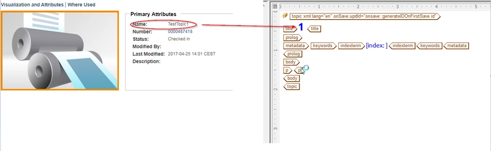

Is it possible to fill the content of a title element, for example from a topic, with the name of the textual content holder from windchill.
So when you name the textual content holder in Windchill 'Test Topic', the title element contains the text 'Test Topic' when opening the topic in Arbortext Editor.

Please explore the topic of bursting, this allows mapping of XML data to Windchill attributes and vice versa.
http://support.ptc.com/help/arbortext/r8.0.0.0/en/#page/admin%2Fcms%2Fhelp6393.html%23

Thanks @GarethOakes, the help documentation contains all information I needed.
Next time I will read the help file first.
