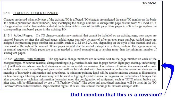

    Change bars should only appear on change pages. When you create a revision, all of the dot pages, dot paragraphs and change bars get rolled into the new document which is now rebaselined.
    Jun 29, 2011 1:08 PM UTC
    Kathleen,
    That can be true, unless you are preparing revisions for the US military. When asking the question you didn't specify what king of manual you were changing or what kind of software you are using. I do not want to argue; I was asking for information on your target requirements and what kind of software (and Stylesheet) you are using.
    For military revisions administrative changes (dot pages, dot, dot objects, enumeration changes, grammatical changes, and previous changes) are all nulled out and change bars are only displayed for technical changes that occur within the revision. For example, look at the change marks in the newest revision of TO 00-5-1. It has change bars on technical changes.
    Excerpt from TO 00-5-1, newest revision, dated: 1 May 2011 (highlighting mine) (you should be able to find a copy if you want it, it is marked as: Distribution Statement A - Approved for public release; distribution is unlimited).
    2.16.2 Change Page Marking. The applicable change numbers are reflected next to the page number on each of the changed pages. Whenever feasible, change markings (e.g., vertical black lines in page border, light grey shading, underlining, etc.) will indicate where new text changes occur in an update or revision. <snip> (see screen shot below):

    Jun 29, 2011 10:51 PM UTC
    The Change Page for Defense help lists what happens for each type of Revision.
    You will find that there is a Complete Revision and an Official Revision. The
    Complete Revision does not contain any change bars. The Official Revision allows
    changes to be marked for that revision and that is probably why you are seeing
    change bars.
    I looked at the help in 5.4, so it may have changed in a later release, but use
    the Change Page for Defense Help and search for Revision. You will find both
    topics in the results.
