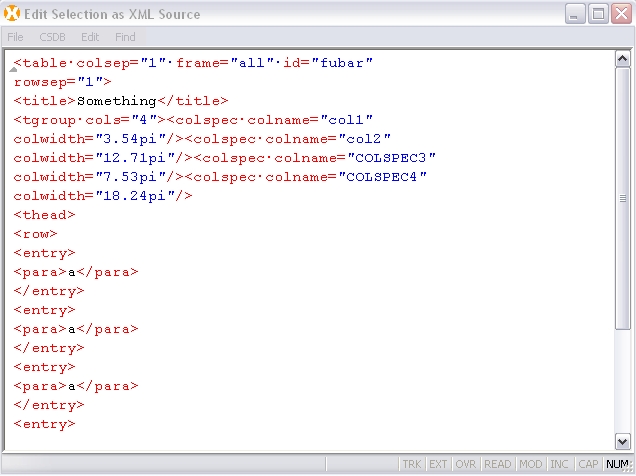

Source Code, showing the variable width colwidth attributes:

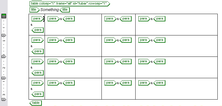

The table in the editor clearly shows variable column widths:

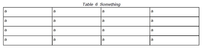

S1000D PDF Output: divides all columns equally between 38 picas
