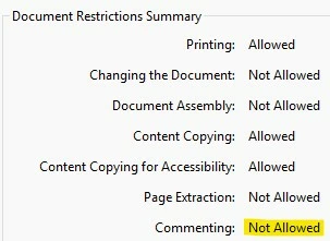

Hi Arbortext Community,
I'm trying to secure PDF documents with an appcf file using the security element, but I want the user to be able to comment on the PDF. The issue is that, somehow even setting noAnnots="no", I keep having the Comment Creation as Not Allowed in the PDF protection menu.
Does someone know how to solve this?

Try using: noModify="no"

But the user shouldn't be allow to modify without a password.

We were unable to solve this issue.
The goal is to forbid modifications but allow commenting.
Based on PTC documentation, this should be the relevant appcf configuration:
<Security masterPassword="xxx" noAnnots="no" noModify="yes" ...... />
However from our testing, the resulting pdf does not allow comments.
Perhaps noModify=yes overrides noAnnots=no because comments are considered modifications?
We are using Arbortext with Styler 8.2.2.0.
