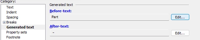

Setting font and size of Generated Text in the Styler
I want to be able to set a particular font and size for the category Generated Text in the styler.  I don't see any font settings inside the window when editing the generated text.  All I'm able to do is specifying Normal, Bold, Italic and so on.
Thanks for your precious help and advices.

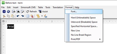

Jan 23, 2025 5:43 AM UTC
You can do that from Edit>Modify Font Menu.

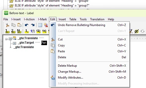

Partner14-AlexandriteAuthor
Jan 23, 2025 1:24 PM UTC
I don't see Modifiy from the edit menu, only have Modifiy Attributes... and Modify Processing Instruction which is grayed out.  Please provide the complete steps.
Thanks.

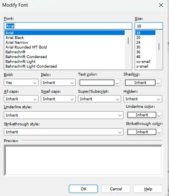

bfriesen
18-Opal
Jan 23, 2025 1:33 PM UTC
If you highlight your text then choose format, font it will wrap your text in a font wrapper.
