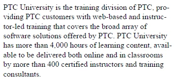

APP Styler hyph rr 2-col.pdf(fixed word spacing)has~77 hyphenations. The following paragraph in Chapter 1 suggeststhat hyphenation is set to a maximum of two successive lines. Otherwise, it seemsthe word "software" on the fourth linewould have been hyphenated. As it is, the third line is left noticeably short.

APP Styler hyph rr wordsp 2-col.style(variable word spacing)has~32 hyphenations, including three successive lines of hyphenation, which suggest the setting may not be two lines. However, the hyphen in "web-based" is authored, which perhaps makes a difference.

InAPP Styler hyph justified 2-col.pdf(fixed word spacing), despite ~67 hyphenations there are a lot of tight and loose lines. Also, "cour-seware" is incorrectly hyphenated.
