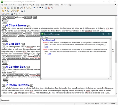

Styler Namespace Error
I'm receiving this error when opening my XML file.
Cannot evaluate XPath expression in stylesheet. [A30282] Invalid XPath expression: The prefix 'x3b2'
I've tried to add x3b2 to the namespace declaration but I cannot locate the namespace value.
Any help would be greatly appreciated.

Aug 17, 2023 1:49 PM UTC
Hi Sarah
x3b2 is a prefix for an internal namespace of extended xpath functions in the ALD Print/PDF engine (formerly 3B2) that styler assembles stylesheet code for so it is not a XML namespace issue,
I assume somewhere in your stylesheet you might have ALD coded source edits?

Aug 17, 2023 3:32 PM UTC
We have just started seeing this, and haven't upgraded recently. We're running Arbortext Editor with Styler version 8.1.3.0, and we're seeing it in both our stylesheet and the PTC provided sample stylesheet for APP Form Fields (C:\Program Files\PTC\Arbortext Editor\samples\APP\PDFFormFields).
For testing purposes, we did download version 8.2.1, and we are seeing it here as well.

Hello Sarah,
This behaviour may take a little bit of tracking. I am able to replicate the error when I open the shipped FormFields.xml from the install samples.
Would it be possible for you to open a case with PTC Technical Support and we can investigate it further.

Dec 21, 2023 4:05 PM UTC
Hello Sarah,
The behaviour has been tracked and there is a problem within the stylesheet.
The way to resolve the issue is noted in the Article - please review the content of the Article.
If you still have issues with your own stylesheet please raise a Technical Support Case with PTC Support.
