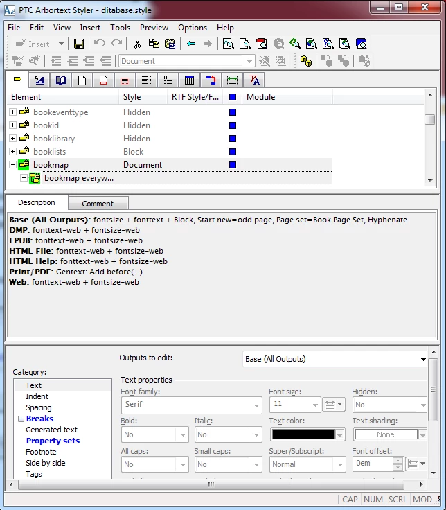

    Hi John
    What Clay said. Attached is a screenshot showing the OOTB output formats
    available in Styler.
    Liz
