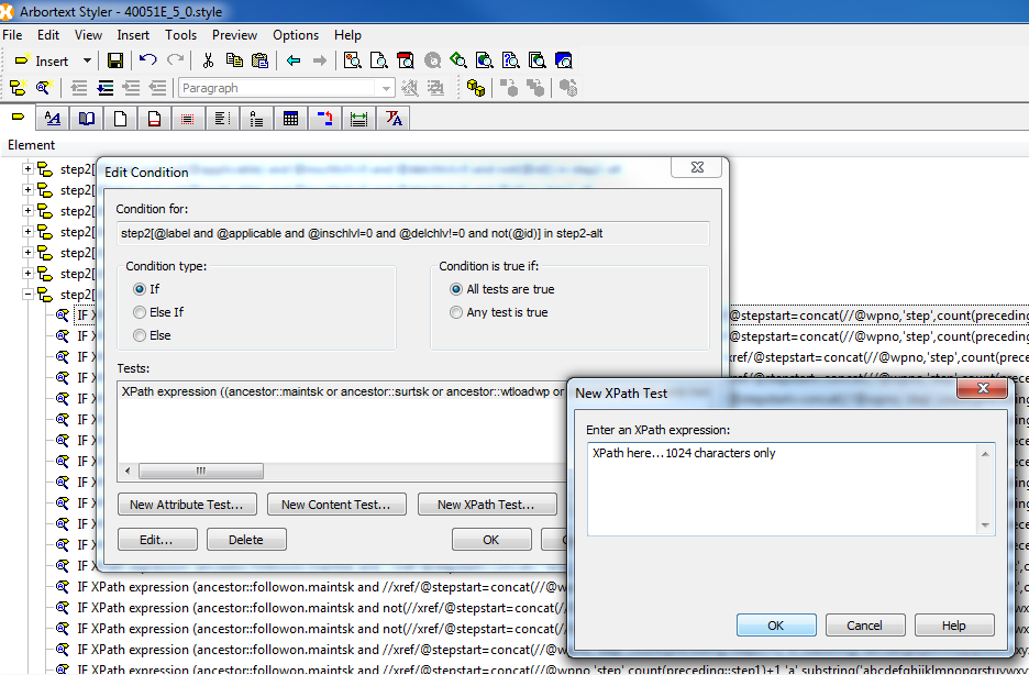

In Arbortext Styler 6.0 once a context of an element is defined one can test the context by adding conditions in form of a New Attribute Test..., New Content Test..., New XPath Test..., and New Chunk Test... (see the picture).
If New XPath Test selected, then XPath expression length cannot exceed 1024 characters. If longer, then the expression would be truncated and therefore incomplete.
The number of conditions/test cannot be higher then 46000, see  https://support.ptc.com/appserver/cs/view/solution.jsp?n=CS40095.
With the new Arbortext Styler 7.0 coming up in mid August 2015, I would like to know if these limits have been increased or not. I would be very happy to hear that they have been increased.

According to R&D the 46000 test issue was fixed in a 6.1 F000 and this is confirmed in the link you sent.
For the other limit, do you have an SPR or Community Idea related to this? That is the preferred way of getting changes to the software.
