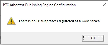

Feb 13, 2022 8:15 AM UTC
A reinstall should sort it, otherwise you may be able to register the PE COM server using regsvr32.exe.
Feb 16, 2022 6:07 PM UTC
In a command prompt window that is running as Administrator, you can navigate to the editor.exe in bin\x64 and do
editor -RegServer
You can also run the PE Configuration tool and it will ask you if you want to register editor as a COM server.
