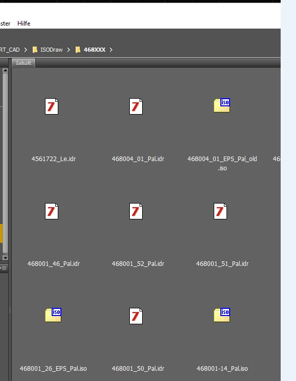

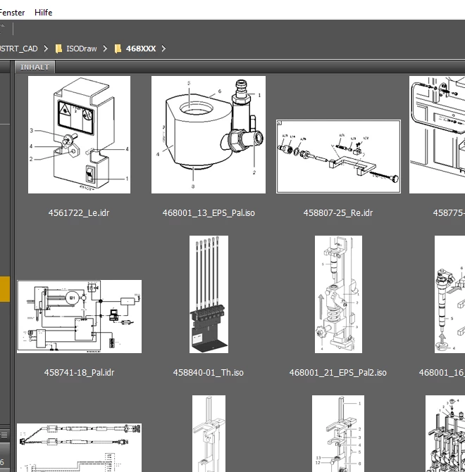

our Team uses for image search Adobe bridge CS6 and it is working fine. Every Isodraw file in Adobe bridge CS6 is showing as a thumbnail. Fine.
Now, we have new group members and they uses Isodraw also. Same version, same pc. But the image search in Adobe bridge CS6 is not working. Instead the thumbnail is the programm icon shown. In the attachment there are two screenshots. How can we solve the issue? Any ideas?

Do you have the thumbnail viewer installed ? In the isodraw install folder, there is a thumbnail folder with the Isodraw install folder that has the thumbnailer installer.

It worksSmiley Happy Yeaah.
