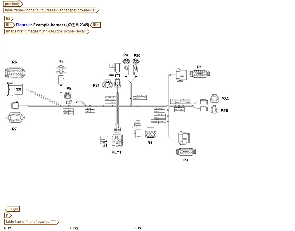

Title and landscaped table and image on the same page?
I have a topic where I would like the image landscaped. We have modified the style sheet to give us this capability by setting outputclass to landscape. I functions and turns the table with the image in it landscape. The issue is that it does not keep it on the same page as the title. Is there an easy way to make this work? See attached files. I can rotate the image in IsoDraw and have the table at the bottom of the image. I think it would look better rotated.

Hello Bryon,
In your styler on the title in figure context , does forcing the breaks to "No word breaking" instead of "Derive" fits your needs ?

Can you put the title in the header of the pageset?

Hello Bryon,

Hi Bryon,
Can you let us know if you were able to get the desired output using one of the methods above, or if you still have any issues or concerns? Thanks!
