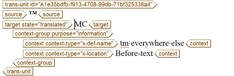

I am updating the french xliff file to automatically change the TM symbol to MC, and the reg symbol to MD when published. I cannot seem to find any symbols that are already created in a superscript MC or MD. I have not seen any way to modify the text in the xliff file.

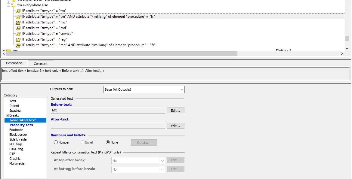

Worked through the issue with Tim P @unknown support. The xlff file allows for text to swapped when you translate. The issue with the xlff file is that you do not  get to add any sort of styling to the text. So we ended up making the changes in the stylesheet to test for tm and procedure to xml lang:fr. This allows you to style the MC and MD as required. Thanks Tim.
