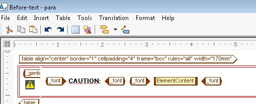

I am trying to translate the manual to FRENCH locale and it works fine everywhere except the Generated text of component which is composed of a Image , Text and element content. like below ,
If I translate CAUTION to say FRENCH CAUTION in XLIF and import and do a publish with lang=fr ,it still shows CAUTION and not FRENCH CAUTION.
Is there any issue or sould this be handled differently  ,pls help

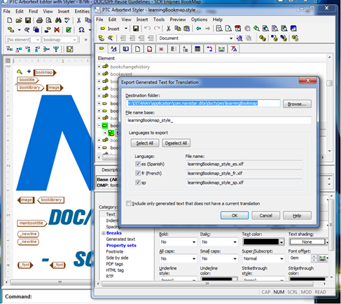

      Here is a process I have used. There may be other ways to do this and I hope this does work for you.
    Setting up Translation Text in Styler
    The following procedure enables you to set up translations for other languages used in Styler. This will allow you to modify translated text or create new translations as required.
    Process:
    1. Open Arbortext with Styler
    2. Select your target document and open the document
    3. Open Styler

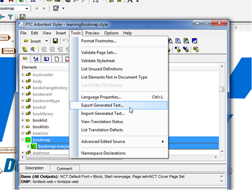

    4. Select pull down Export Generated Text
      1. Select a spot to put this file
      2. Select the language(s) you want to export
      3. Select OK

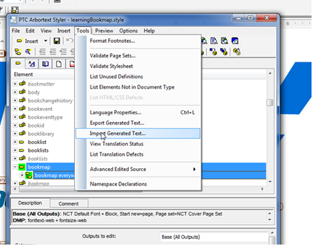

    10. Open your target document and open Styler

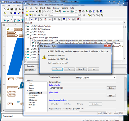

    11. Select Import Gent Text
      1. If you get a notification message, select “No to all”.
      2. Save the stylesheet
      3. Try a sample publish using Arbortext Editor with Styler locally
      4. For PE/APP server processing, it is necessary to restart the server.
      5. When document translations are checked out delete the working files saved on your local disk.
