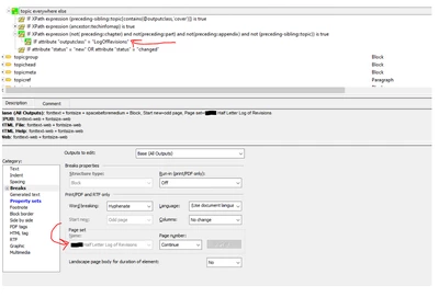

Triggering a New Page Set in a Book Map
I am attempting to add a new topic to my book map with its own unique page set. When I publish the topic to .pdf on its own, the correct page set populates, but when I publish the whole book map, this topic does not have the correct page set. Any pointers on what I may be missing?
Info: I am using PTC Arbortext Editor with Styler 8.1.1.0

Using Arbortext Styler, open your map, then go to edit, edit resolved document for styling. Once the ditabase is open, click styler, edit stylesheet and open the current stylesheet. Have them side by side. When you move your cursor through the elements it should show you in styler what conditions are being used, When you get to the new topic you added it should show you what is being used when it is publishing.

I have tried this, and when I select the new topic, the highlighted condition shows the correct page set (see below).
Any thoughts on where I may be going wrong?

I always forget what he rule is but there are two contexts highlighting. My guess is that it is using the upper one. If you open the topic by itself and look at it through styler does it highlight the same contexts?
