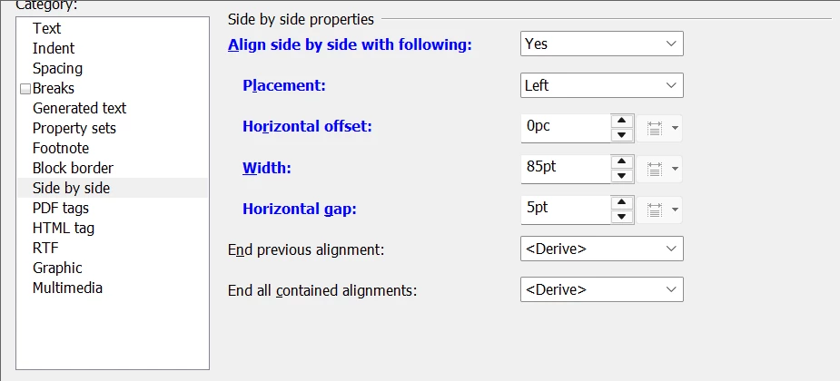

In many places inside my document, I have elements like "Section, Subsection, Paragraphs etc. that have a Label g.e. (a) and a Text content.  When the length of the Label differs from one element to the other, the right Text element gets misaligned.  I found out that the Side by side feature would let me produce the desired result.  But, setting those have no effect in the editor.  I don't need this feature for exporting, only inside the editor.  I have followed the steps from => https://support.ptc.com/help/arbortext/r8.3.0.0/en/index.html#page/styler/styler/help27579_3.html  and never was I able to get the result.    Here is a specific case with my settings.    A subparagraph have a Label and a Text.  Setting for my Label element (first on the left) : Element is inline (I don't want new lines.)Element is inline (I don't want new lines.)Side by side setting of Label in that contextSide by side setting of Label in that context

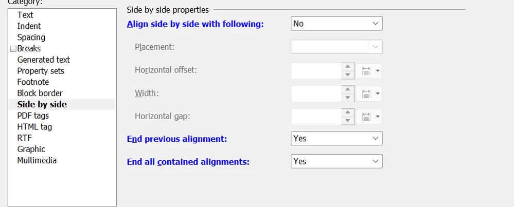

And below setting for the right element (Text) : Screenshot 2025-07-31 100153.pngScreenshot 2025-07-31 100209.png

Look at the techinfo applicaiton that is shipped with Arbortext editor. It uses the sidebyside output.
