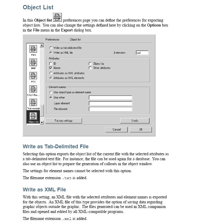

    are you owner of the handbook "User's reference" (you can download it from the PTC homepage)?
    In the englisch version on page 136 you can read how to set the preferences of an "object list"export.
    You can export the structure of the 3D-Model (in opposition of my last statement) as an XML-file (just switch to export > XCF File). You can open this XML-file in every text-editor you want.
    Did that help?
