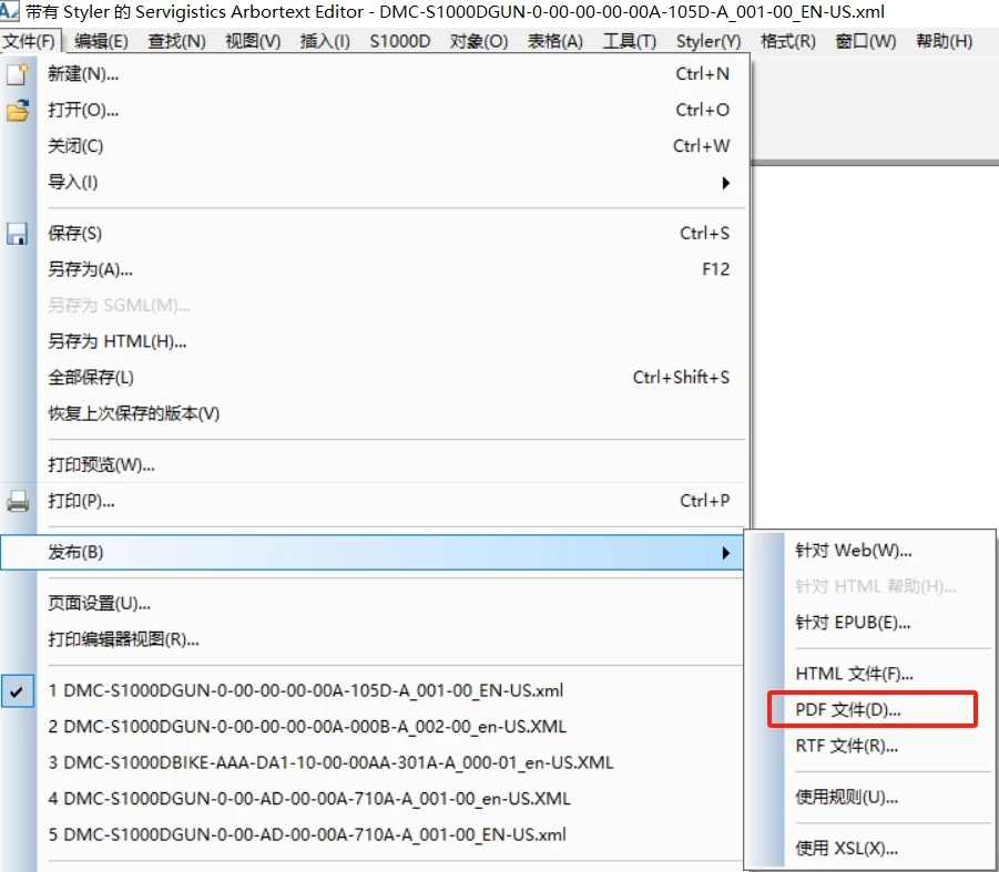

Use Arbortext7M080 Publish a S1000D publicModel to PDF
When I used Arbortext7M080 open a S1000D publicmodel.then used publish PDFfile command to convert a PDF file,but the graphic can not display.But when i open a datamodel and convert a pdf file the graphic can display.so is there anybody can tell me why?

Thank you very much! I have watched the videos you uploaded.But the methods in the video don't work for me.
I was used the Arbortext Editor menu:Files--》Publish--》PDF Files to Published a public module as PDF file,but in the PDF file has not graphic .The public module reference a lot of Data Module(not include data module content).could you help me solve this problem?
