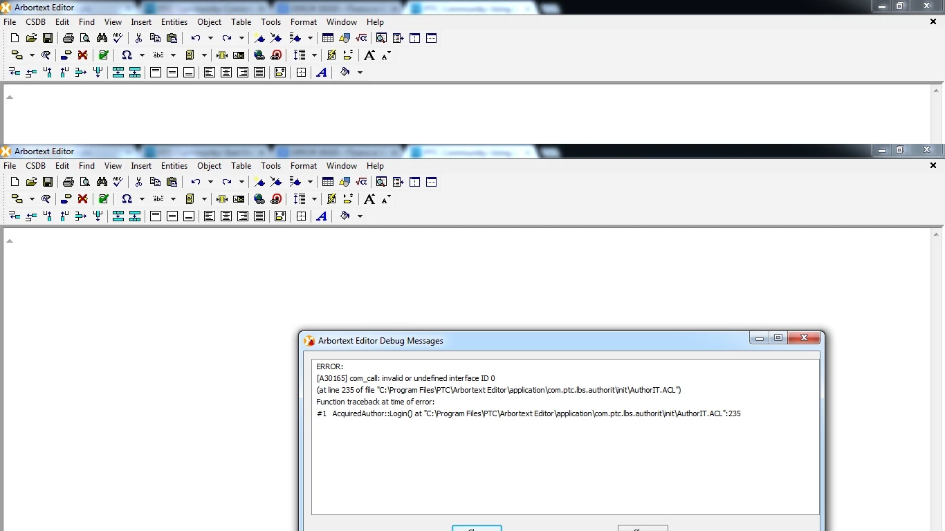

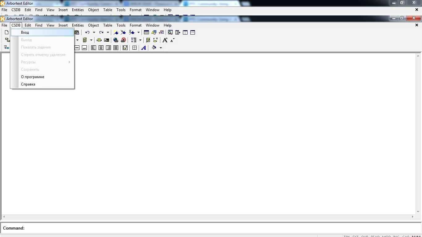

Hi everyone,
We want to use Arbortext Editor 6.0 with Arbortext CSDB
We install Arbortext Authoring Interface for Arbortext Editor.

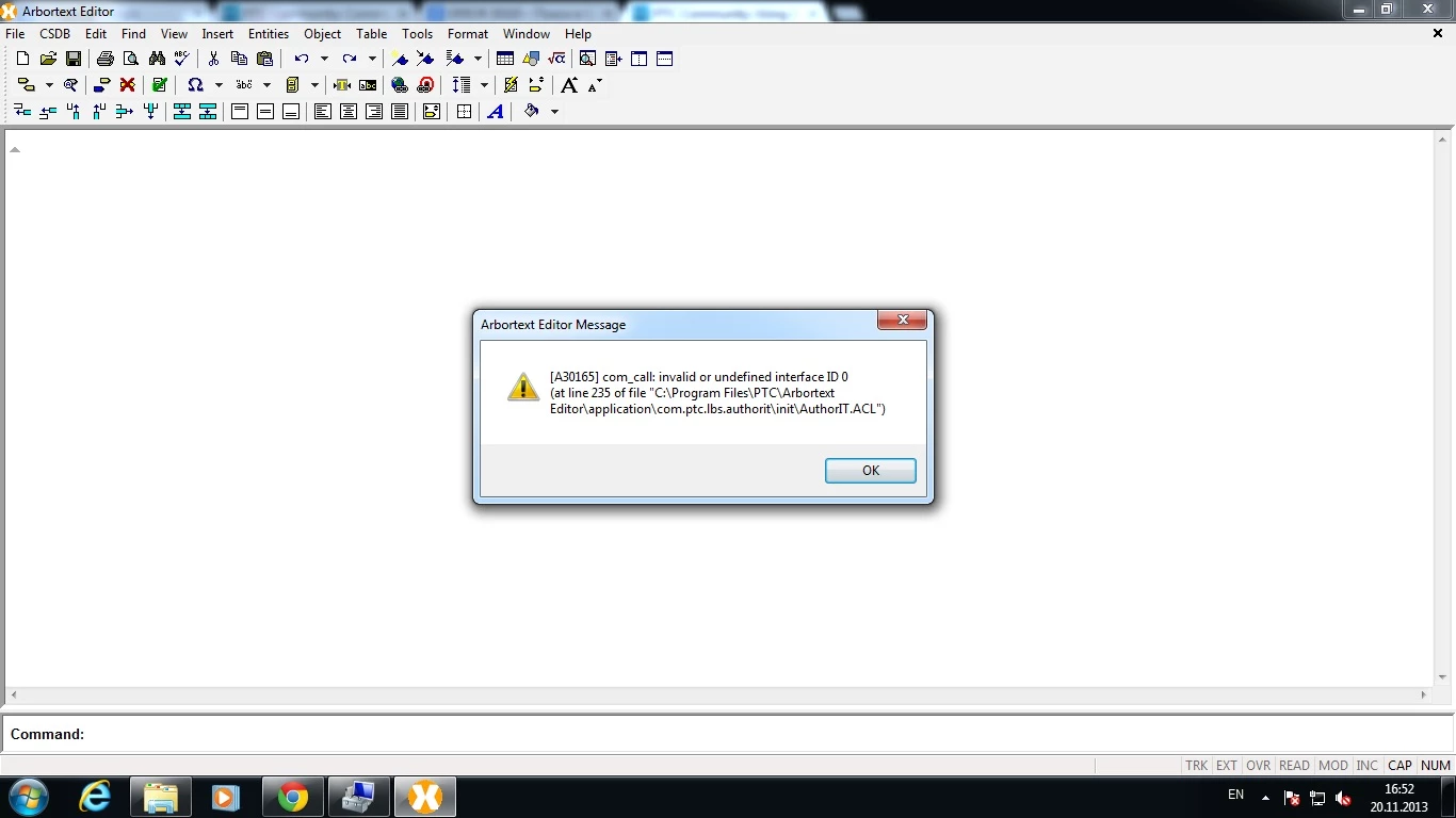

In Arbortext Editor, we can see CSDB menu in toolbar (Connect to SCDB.jpg) When we click to login in CSDB menu, we gets another error (Error.jpg)
  • ERROR:
[A30165] com_call: invalid or undefined interface ID 0
(at line 235 of file "C:\Program Files\PTC\Arbortext Editor\application\com.ptc.lbs.authorit\init\AuthorIT.ACL")
Function traceback at time of error:
#1 AcquredAuthor::Login() at "C:\Program Files\PTC\Arbortext Editor\application\com.ptc.lbs.authorit\init\AuthorIT.ACL":235
In row 235, you can find: loggedin = com_call(AcquiredAuthorHandle, "Login")
Is there anyone facing same issue before and/or have any opinion about solution?
Best regards,
Artem Baketov
Best answer by ptc-5297369
Development have stated that Authoring Tools Interface will not work with a 64-bit version of Editor as we do not currently support it.
I use first a 64-bit version of Arbortext Editor. I deleted 64-bit version and install a 32-bit version of Editor.
Now the problem with the error disappeared, ATI working properly.
