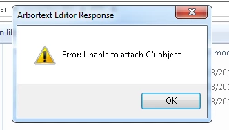

While opening, Arbortext Editor gives an error:
  • Error: Unable to attach C# object (01.PNG)

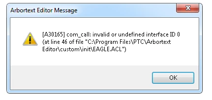

When we click to EPS Plugin in EAGLE menu, we gets another error (03.PNG)
  • ERROR:
[A30165] com_call: invalid or undefined interface ID 0
(at line 46 of file "C:\Program Files\PTC\Arbortext Editor\custom\init\EAGLE.ACL")
Function traceback at time of error:
#1 Artwork() at "C:\Program Files\PTC\Arbortext Editor\custom\init\EAGLE.ACL":46
In row 46, you can find: "local login_result = com_call(EAGLE_Handle, "Login", dirname, filename, version_number);"
Is there anyone facing same issue before and/or have any opinion about solution?

This is a known issue with the EAGLE/EPS Plugin installation. [FIX] = Go to the EAGLE/EPS install directory (default = C:\Program Files\RSC\EAGLE 2B ELT [32 bit OS] or C:\Program Files(x86)\RSC\EAGLE 2B ELT [64 bit OS]) and run the EPS_Plugin_Install.exe and make sure that it points to the CORRECT Arbortext Editor install directory when the install prompts you. This will fix this issue.
