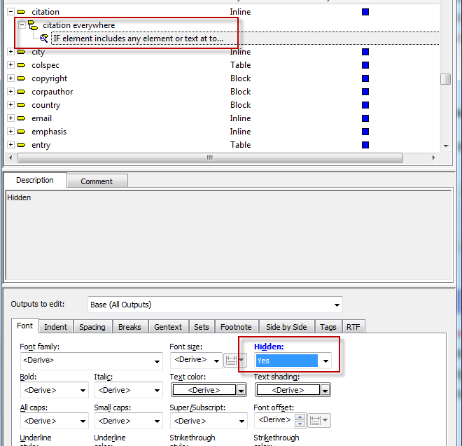

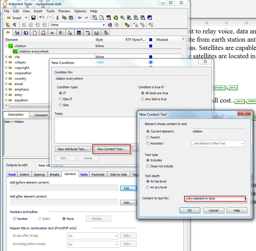

If you need it to be based on content, it's just as simple as creating a new context for the element.
Below you can see I'm in the process of adding a new context for the citation element.
Select 'New Content Test' instead of 'Attribute Test', and have the check simply be for any content:
Here, we see the new context, and we can modify the element to have content hidden:
Now just add the desired gentext as normal. Note, in the Editor view, you will see both the content typed, and the gentext (if it is turned on), but in composed output, you will only see the gentext:

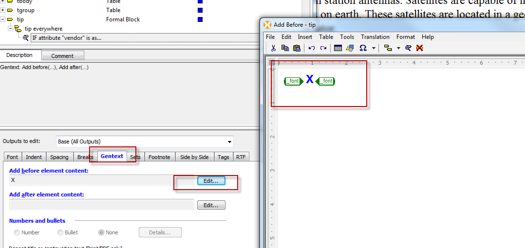

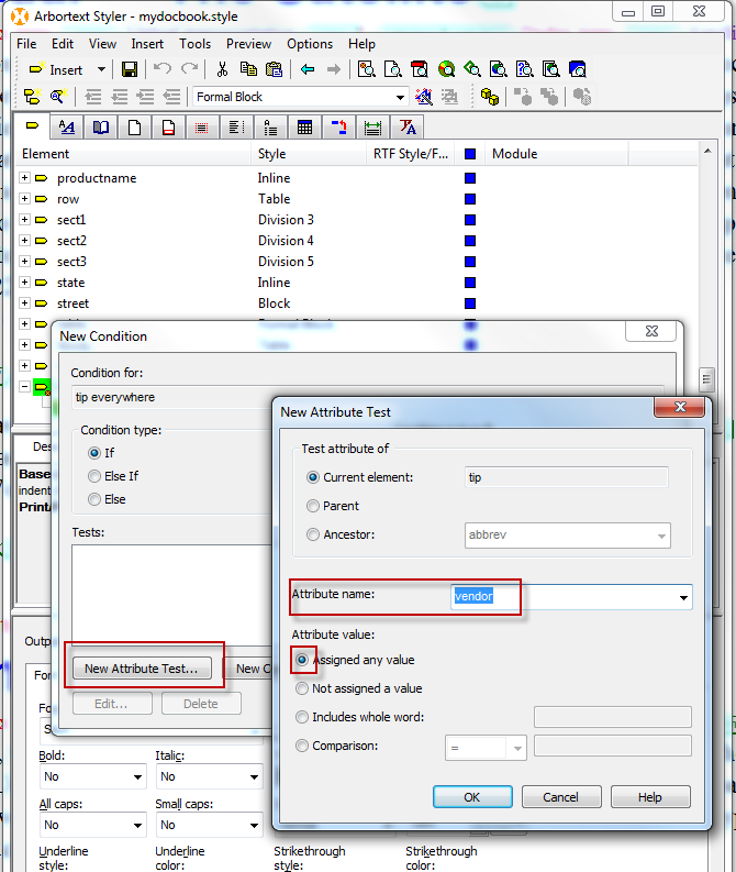

Robson, this should be doable in a few short steps:
1) Create a context for the attribute being used. In my example, I am using the <tip> element, and creating a context where If attribute 'vendor' is assigned any value
2) After that, in the element, click the gentext tab, and modify the gentext:
3) Resulting element in the Editor would be:
As an additional step, you can also set other content in that element as hidden, in case users do type something in, then in composed output it would not be seen. Or, even better, you can set the element itself as not accepting text in the DTD, and still insert gentext as above.
